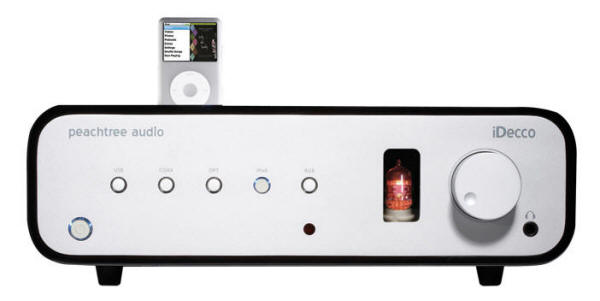

Encore une revue positive du système tout-en-un Peachtree Audio iDecco (dock, DAC, préampli à tube, ampli casque à tube, ampli), avec notamment comparaison des sources iPod et lecteur CD Arcam 82 alimentant l’ensemble iDecco, enceintes Gingko ClaraVu 7 / Tannoy Eyris 1 / Nola Boxer et caisson de basses Velodyne Optimum 10.
Qualité sonore iPod + ensemble iDecco > Qualité sonore lecteur CD Arcam 82 + ensemble iDecco
Trumping the Arcam 82 CD player for a surprisingly unexpected first place was the iPod doc. Music jumped out of my speakers with a fullness and depth that is hard to describe. Lots of string snapping bass runs in this song, and the iPod doc gave even more heft and detail to the bottom rumble than the analog CD could muster. Maybe I was suckered in by the varying output level of each source, but I discerned a more distinct soundstage and imaging, too. Keyboards, guitar fills, and the occasional bell tones were also more convincing when played through the iPod (how many times have you ever read that sentence?).
The point of all this is, of course, is that my Arcam 82 CD player cost about $1100 new, and the iDecco makes the purchase of a comparable CD player unnecessary, given a loaded iPod and plenty of lossless files.
Truly a revelatory experience, and something that greatly adds to the cost benefit of the iDecco.
